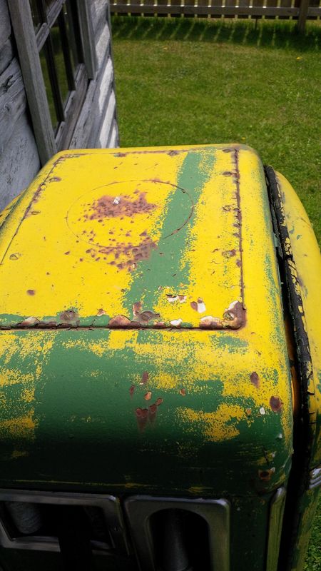

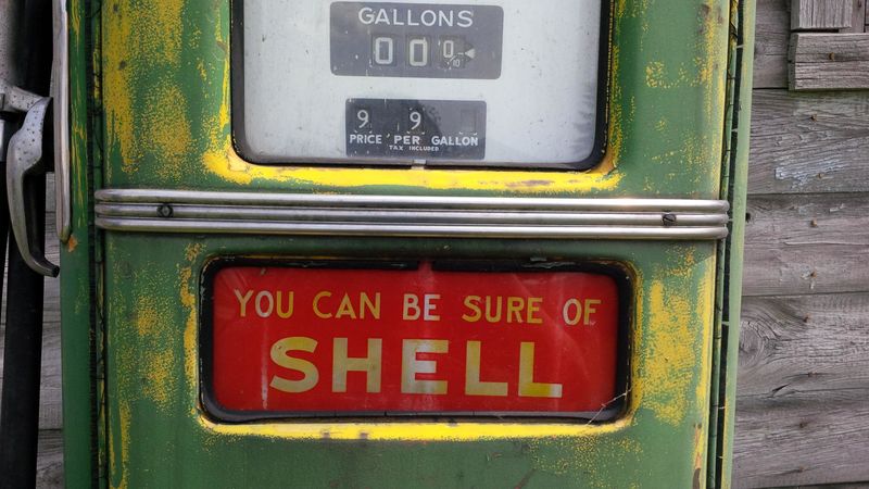

To get things rolling, here are some pictures of it as it was behind the garage. You can see the base paint job peeking through the fading green paint.
Right now, I am going to have a big job trying to find some of the red and yellow paint inside the pump to color code to....or the correct color codes online!

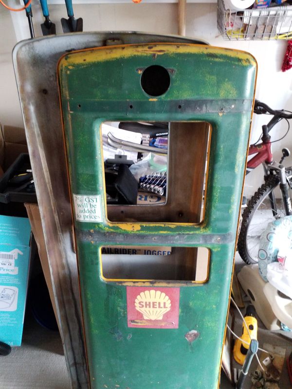

And here is the start of the strip down.
In the future, if anyone is wondering how to open this version of the 996 - It took me forever to get the doors off as I had to find a way to disengage the lock from the top since I don't have the key to unlock the pump. I had to pull the door as forward as possible, while my father jammed a flathead screwdriver into the top slot pry the locking mechanism upwards. Meanwhile, I pulled the door forward to unlock the door.
Alternatively, you could cut the top holder with a grinder (since it is just a strip of metal) and then weld it back together

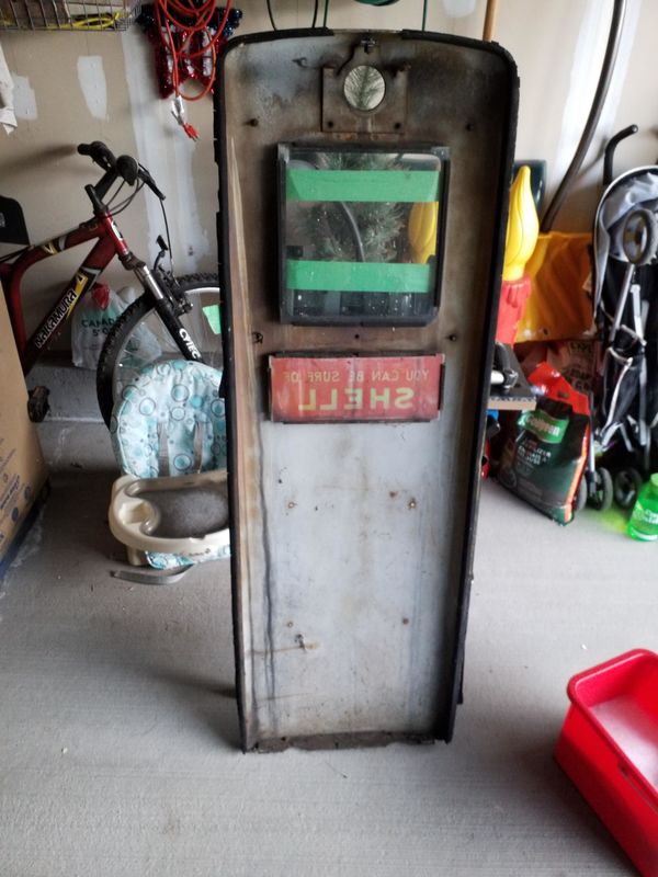

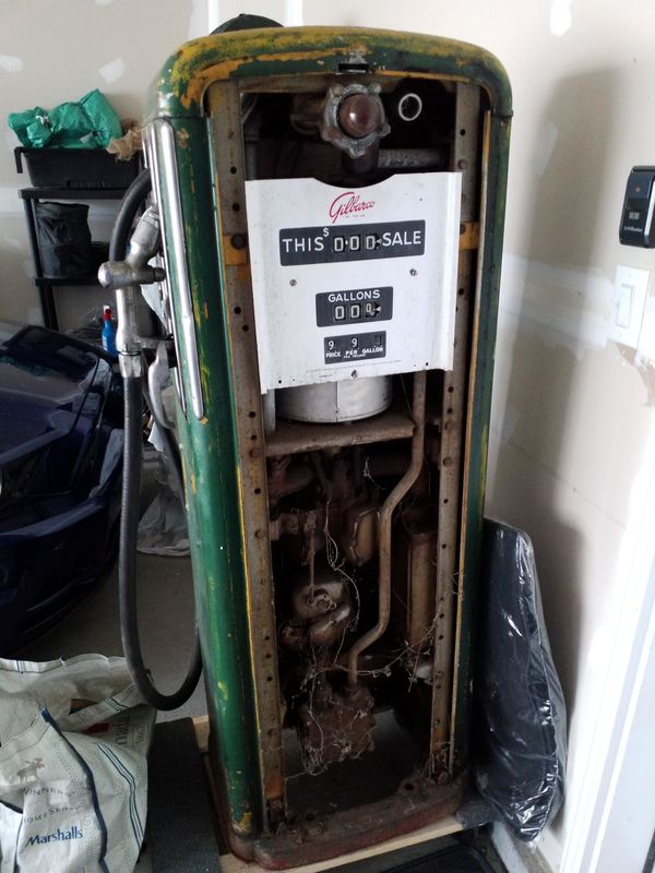

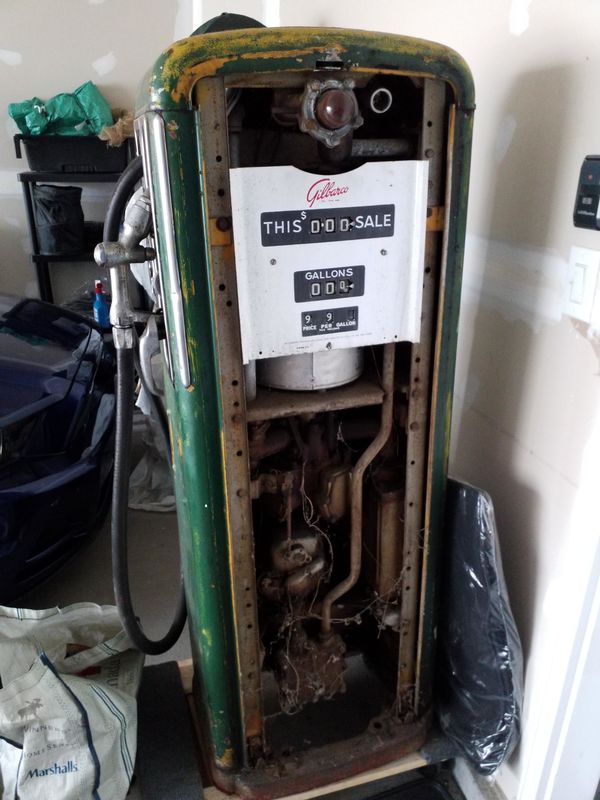

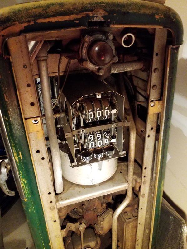

So i have all four sides off finally. The two side panels were additionally bolted to the floor and had a job as one bolt snapped in half when trying to get it out. That'll be a problem for when I deal with the base.
The lock side was the last to go and presented a problem as I needed to free it by freeing the lock mechanism and the overflow spout. Lastly I had to remove the handle or the hose to finish the job. I punctured the hose and had it spit fuel on me, so it was an easy call to slice it in half after I drained the fuel in the hose. I made a makeshift plug with a garbage bag and tape to keep it contained for the time being
I also pulled the faceplate off to expose the computer. I gave the numbers a wiped own, along with the faceplate and both looked fantastic. This was also where I caught the inspection sticker from 1983 as it was affixed to the one faceplate on the inside.
I tossed on a picture of the top to show what the door locking mechanism looks like for context.
Next steps will be removing the motor (i checked the belt and both the motor and the pistons move as they should still), somehow remove the electrical conduit and boxes so i can remove the wiring and rewire (hoping to clean up the porcelain sockets and reuse them) and remove the air exchanger which i suspect is the source of the remaining fuel in the pump. There also is a small leak of oil on the pistons so the seals are toast there for sure. I am nervous about removing the sight glass and having fuel pour out. Inspecting one of them after taking the bracket off showed me that the seals are basically glued to it after years in the elements so will have to scrape off and hope it slides out with penetrating oil.

Nice pump. I like the original ad glass. They are a Canadian design. I have collected some and they all came from Canada.

Matt - i think one of the draws for me for this pump was always the ad glass. I have one seen 2 sets of these come up online for sale at auctions or whatever and was always too late on them. Have been wanting to grab a second set as a spare. I didn't know a lot about them, so I appreciate mentioning that they are a Canadian design. Just makes this pjmp better!
