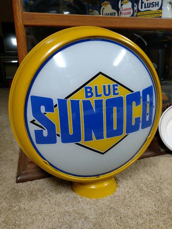

Got the all repop globe ready to go!! Thing is almost to pretty to put outside. Got a great deal on the lenses for only $100 for the pair. So if they fall victim to a kids rock I'm not out to much.
I love this color I had made up at an auto paint supplier. Just the perfect amount of mustard to it for an older style look. I'm not a fan of Sunoco resto's were the color is to canary looking.

That color on your globe body looks spot on.
Heres a picture of an original patinad one I have.
Good luck with your restoration, that dent wont be a problem at all for you.
Nice to hear from you Chuck.
Yeah, it was an original NOS frame right out of the box that I have that I had the paint made from.
Here's something interesting.
Repop on bottom
Real on top.
I wish the repop had the darker blue.
The Sunoco blue was very dark back in those days! The pump will be this darker color.
