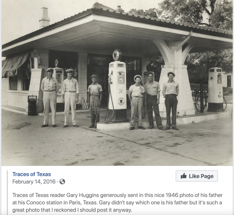

I have an extensive collection of photos of Conoco gas stations. Of these, 220 photos show gas pumps from this 1937-1945 era. Not a single photo shows the M&S 70. Not one. None. This isn’t a coincidence…something is going on here. Of the 220 photos, roughly 70 show the Tokheim 39 tall, 50 show the Wayne 70, 45 show the Wayne 60 and 20 show the Tokheim 36B. The remainder include a few Gilbarco pumps, Bennett pumps, Bowser pumps and Southwest pumps. But not a single M&S 70. Here are two photos demonstrating a typical Conoco station of that era. The first one is a Dodge City, KS grand opening in 1939 (when Conoco already owned M&S) where they use the Tokheim 36B.
