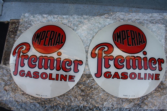

Here are the pictures that were requested.
1918 to 1925 Imperial Premier 16.5 inch globe faces.
They appear to be NOS

I had posted a question requesting information on the proper pump colors for an Imperial pump with these globe faces.
A picture of the faces was requested , so here it is.

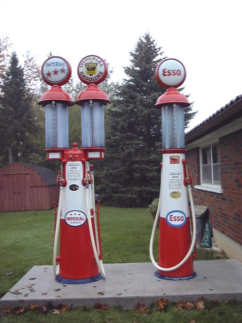

Here's a pair I did for a customer about 10 years ago..
Wes.......

I don't know if they are the exact way of doing them... I've restored a few hundred pumps since the early 60's and it really is whatever appeals to you.. these were done for an Imperial Oil employee of many years and he retired and wanted this display at his house.

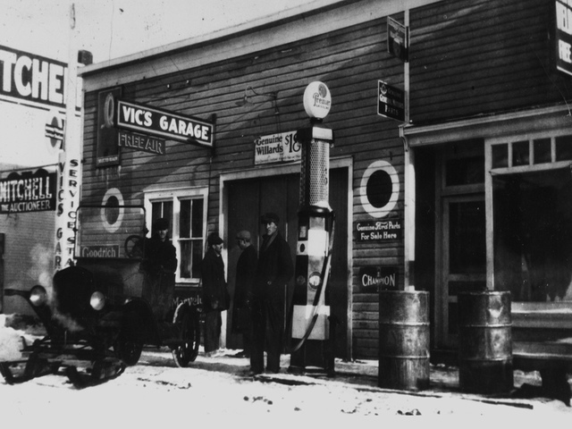

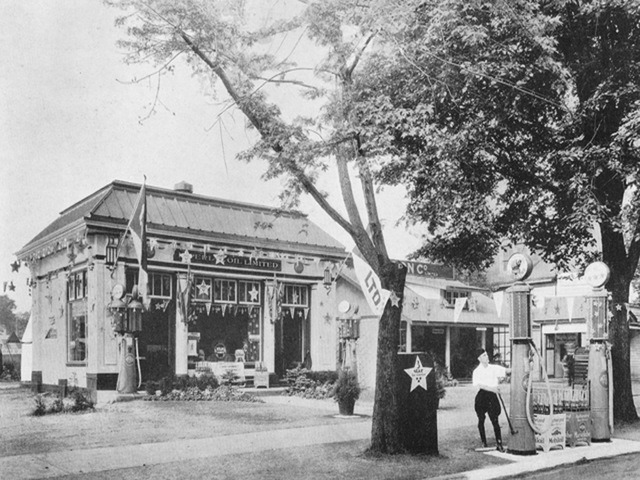

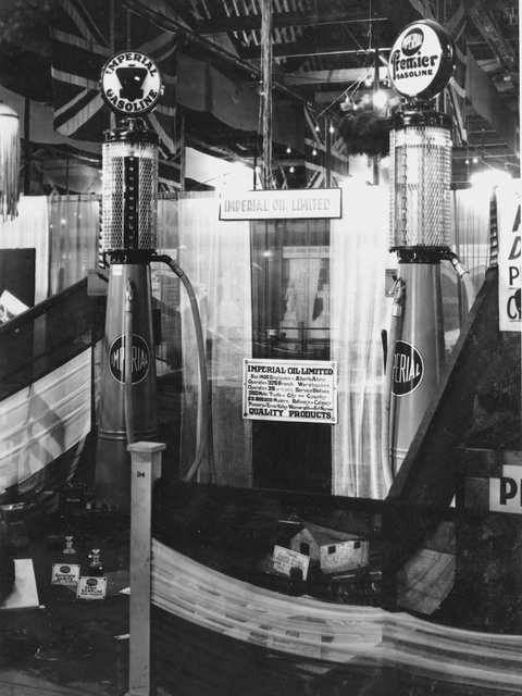

Hi Jim, if your doing a visible pump from the 1920s to go with your Premier lenses you may want to consider two earlier colour schemes that Imperial Oil used. From the photos that I have come across where the Premier globe was used it was either the earlier alternating colour stripe scheme or a bit later, circa 1929 to 1931, was the solid colour. I believe it was a close match to the green on the porcelain marvelube oil jar rack. The colour scheme that Wes and Kim refer to came out in 1933. In the Sept. 1933 issue of Imperial Oil's 'The Salesmotor': "All pumps to be painted red 4/9ths of the distance up from the bottom of the pump to the bottom of the container or bowl. The remaining 5/9ths of the distance from the base to the bottom of the bowl to be white. The lamp standard and frame to be red. The wire screen over the pump bowl to be white." Photo 1 from The Salesmotor, Aug. 1928. Photo 2: Vic's Garage, Millet, Alberta, no date. Photo 3: Imperial Oil at the Canadian National Exhibition, 1931, with 3 Star gasoline, introduced in Ontario Sept. 1931. Photo 4: Imperial Oil display, Edmonton, Sept. 1929. I hope this helps. Cheers, Don.
p.s. Yes, of course the globe could have stayed on for years after a new colour scheme was implemented.
