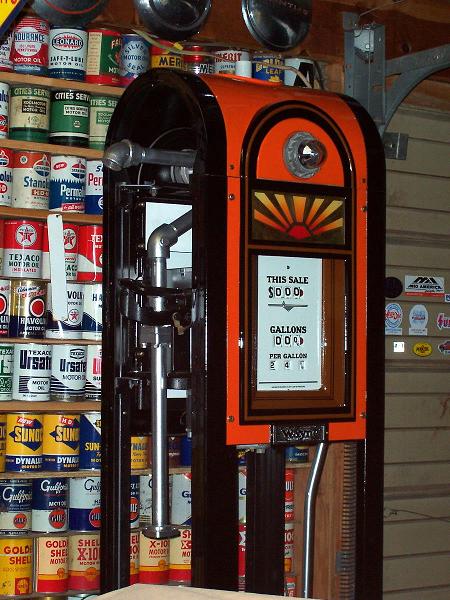

Clear plexiglass, sprayed with orange and yellow on the back side. After that dries sprayed over with white. You can use a spray paint meant for plastic panel from an auto parts store.
ROD [Mich.]

I love that color scheme you have going. It pops nicely even though it's not done yet! Nice work.
