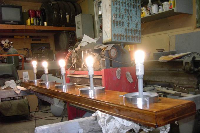

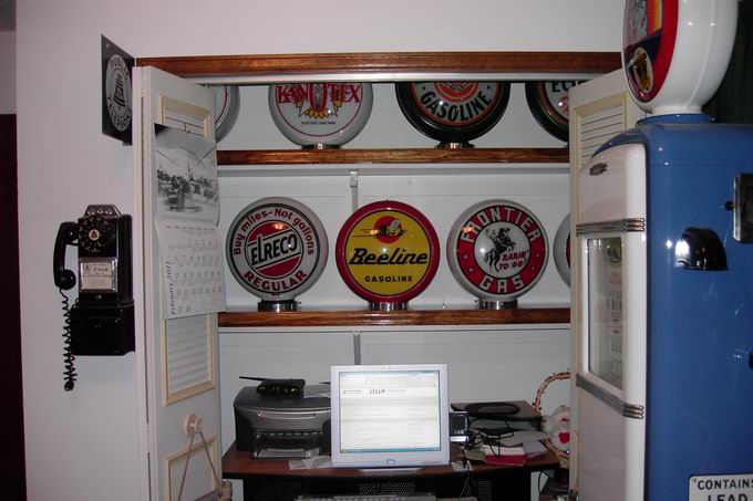

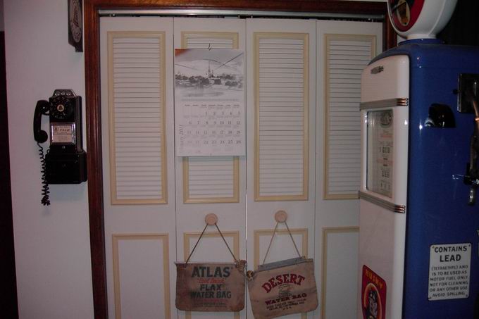

I live in a fairly small house with not to much room, My globes have been stored under the steps in the basement. Safe but not a good place to see them. Years ago when I bought my first pump I put it in my spare bedroom and when I got the computer it went in the closet. Bright idea why not put the globes in the closet with the computer. The first thing I did was add a second shelf 24 in. down from the original one. Here are the results.

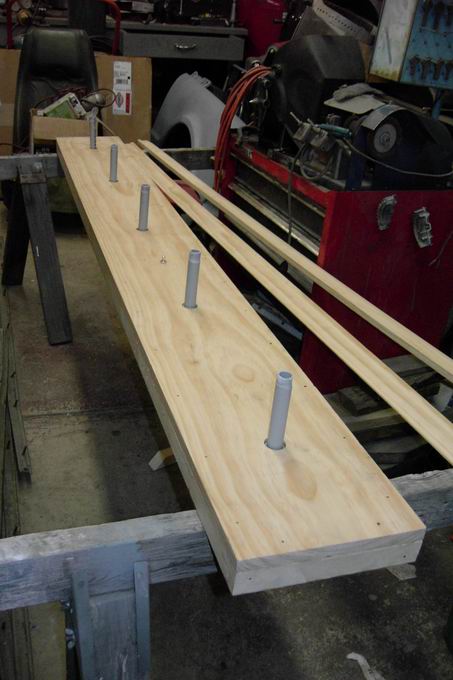

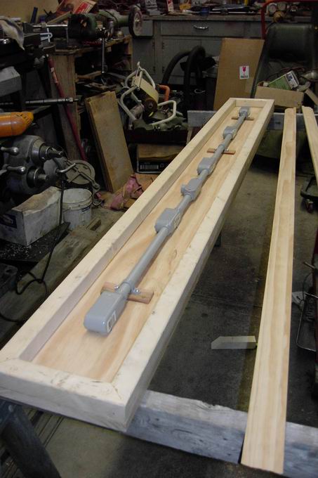

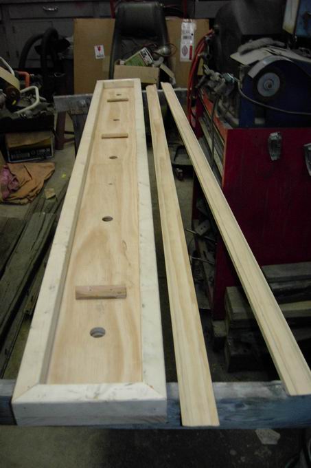

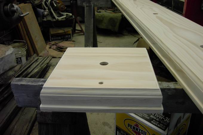

Heres how I made the shelves. First I ordered 12 of the porcelin sockets with 1/2 NPT threads. Then I went to Lowes and bought 1/2 plastic conduit and connections to make up the light manifold. Two 1 X 10 X 8 ft. finished boards and some molding. I cut the boards off to fit in the closet and the pieces left over I made into small globe light mounts. I glued them to angle iron frames for extra weight. Here are the results. No comments about my shop. I thought about starting a thread on here about who had the dirtiest shop but figured nobody would show theirs. Mitch

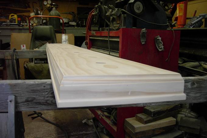

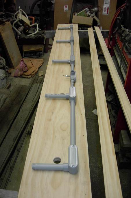

More pictures

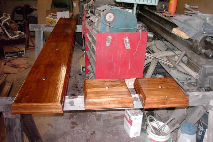

After I got through buiding them I stained and coated them with verethane.
