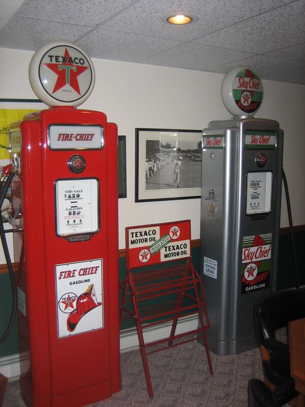

Looks nice. I am/was a Texaco collector for years. Question for you. Does the as nozzle say Wayne on it???

No I don’t see “ Wayne” anywhere on the nozzle, sorry.

No worries....This is not a great picture. I have been looking for another one of these nozzles to go with my red Wayne 70. I think you are doing a great think by your neighbor. Best wishes to her.
