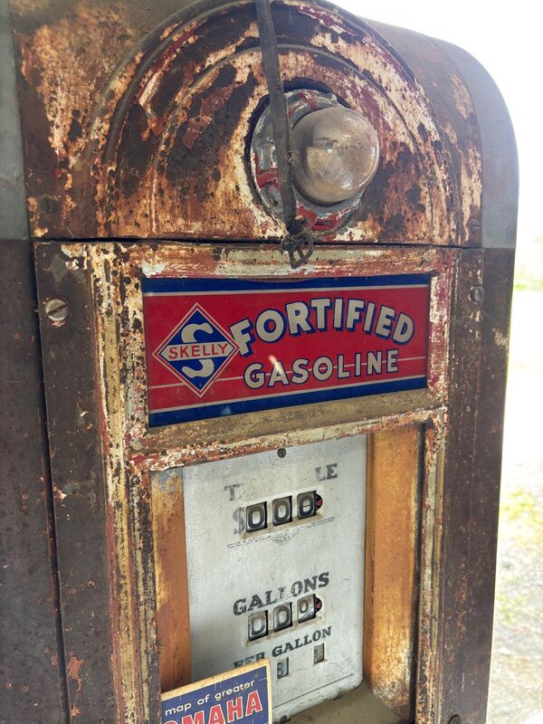

Hello, I was at my neighbors shop yesterday and he showed me this Wayne gas pump. I told him about this site and that I would try to learn more about his pump.
I would like to know the model, and approximate age, and anything else you see.
Thanks Greg

He has removed the pump internals, but still has them. The panels are all decent. It does have a spot on top for a globe. The ad glass on the back has been painted over, I told him we should scrape that off and see what is underneath.
I can take more pics if needed.

Wayne 60 wide base. Made between 1935-46. If you can read the serial number on the id plate, I can give you the year it was made. Richard

I think it is 032 BDO or possibly 932 BDO.
I told him I thought it may be worth $1000 as is. Am I in the ballpark?
He does not want to sell it.

And a highly desirable pump.
