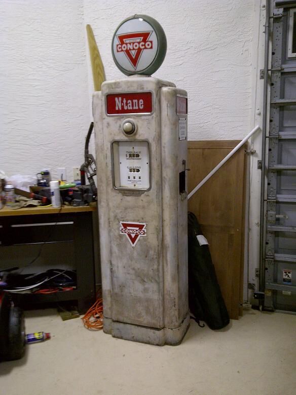

Here's one posted on this board 11 years ago. - Jack J. ![[Linked Image]](https://www.oldgas.com/forum/ubbthreads.php?ubb=download&Number=238023&filename=Conoco-Wayne-70-Gas-Pump.jpg)

I agree with Jim on this one. I would restore it all white with a green base , and a red Royal triangle pump plate.
The only difference is, if you want to keep it somewhat original, I would not paint the top a different color, I would paint it white as well. I have not found a tall Conoco electric pump (Wayne model 70’s, 60’s, etc) in old pictures that has a different color top. The only ones I have noticed with a different color top are the shorter pumps (mostly M&S/ Wayne 80’s and a few Tokheim 39’s).
Plus I think a painted top might take away from the globe.
But in the end, as mentioned above, do what you like and what makes you happy. And remember gas station owners slapped paint on these and they changed to different variations over the years anyway.
