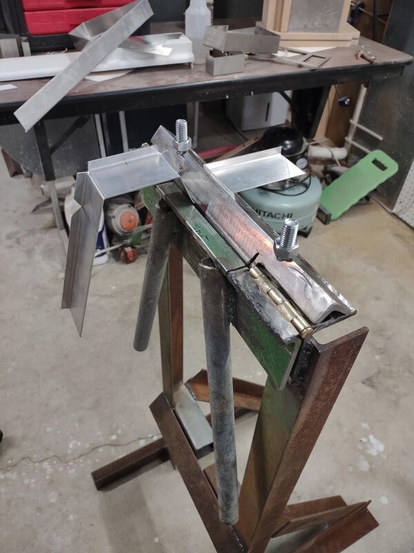

I have been experimenting with making channel letters on my homemade brake. I'm no expert, and am working with homemade tools, but here is what came out. I didn't take pictures of making the letters, but will share what I have. I bent the sign face on the big brake at work.

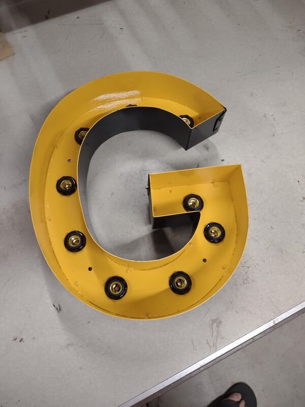

One of the letters done, painted, and sockets installed.

Making a letter

The other part of the A

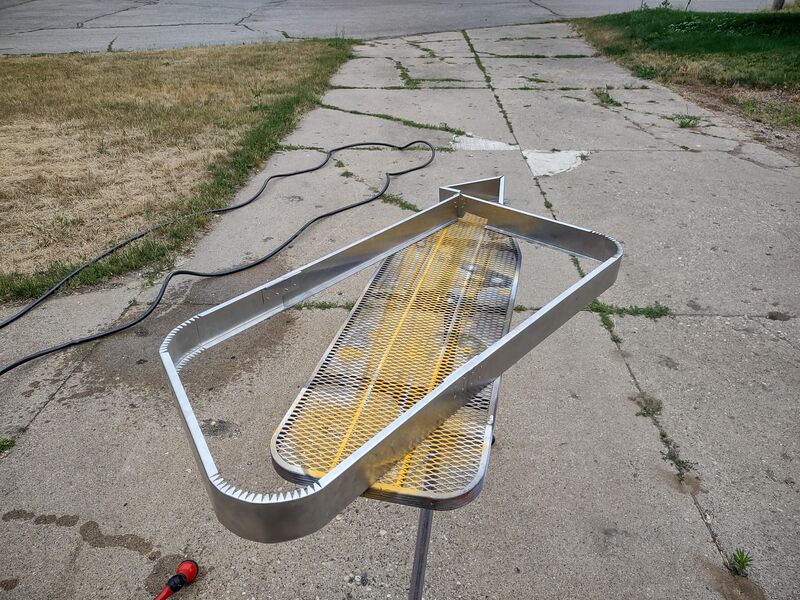

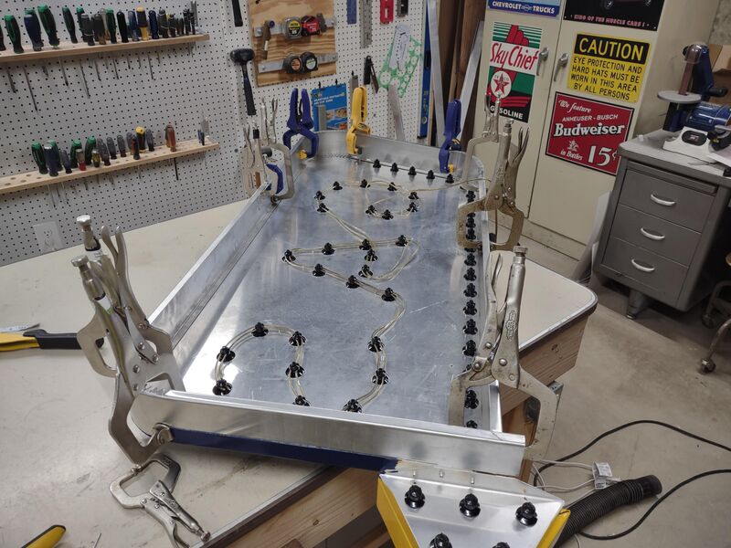

Making the sign can, the part that gives it thickness and holds the electronics.

The can done, and ready for paint

Looks great! A lot of work!
I've made some cans too, not many channel letters yet, but a few.
You may want to pick up an expander/shrinker from harbor freight sometime. I've been using the shrinker on the sheet metal U channel to make round corners or gentle radiuses. You have to shrink one side of the U leg, then the other, and after a while get decent at it. Then you dont have to make the triangle cuts to make corners. Although if its hidden, why not?

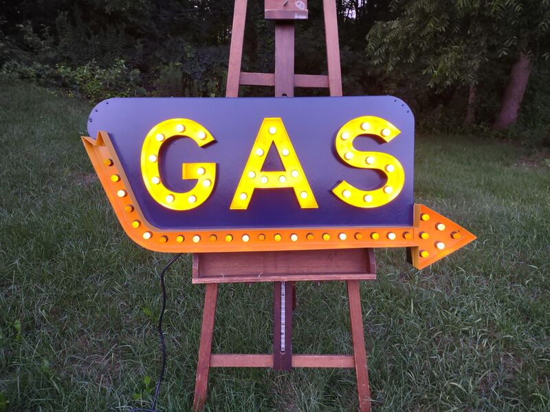

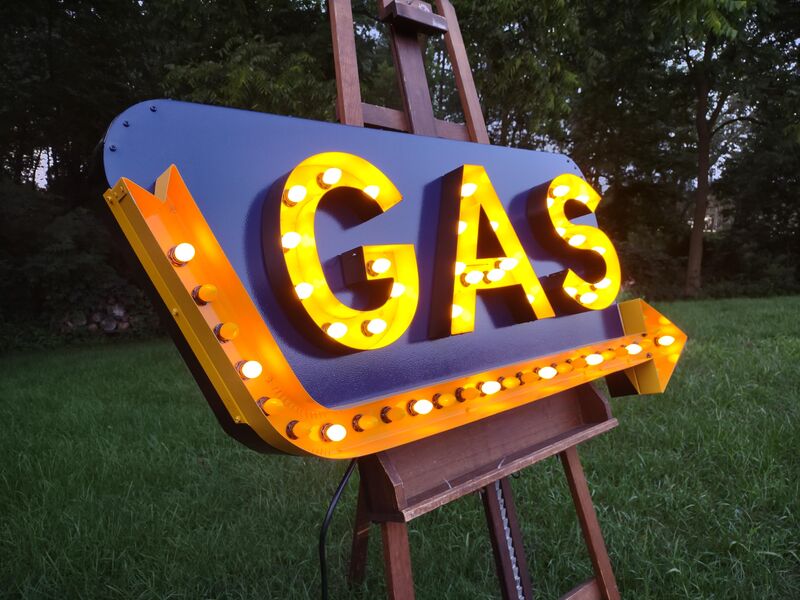

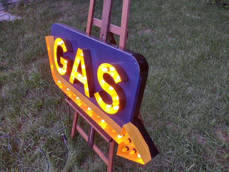

So I forgot I was posting this project here. Here's the finished project. Inspired by a Four Star sign, this is my own design. This was just a fun experiment to see if I could make a good looking channel sign. I'll hang it in my shop.
