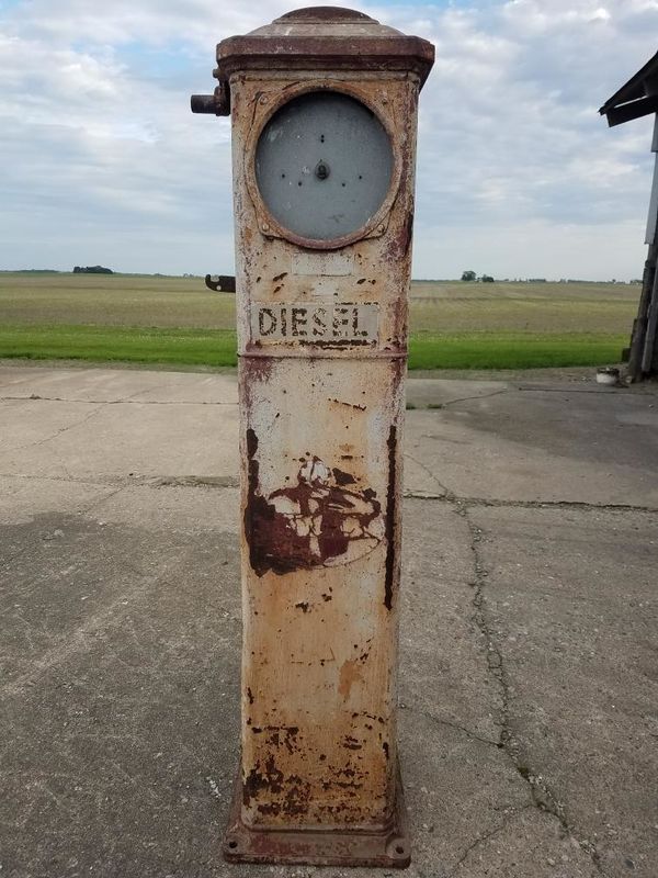

Attending my 1st event at Iowa Gas in Des Moines. Looking to restore my 1st pump - a National Model 90 pump. Hoping to meet vendor, person or people who can provide suggestions and or parts. I have room booked at The Hampton. I know I need clockface on both sides. Thanks for input.

Dan and Vicki at PetroNuts might have those (petronuts.com). They sell reproduction face plates. You may want to contact them ahead of time and see if they can bring you a set. They have a large red trailer at the show and sell glass cylinders for visible pumps.

Make sure you save those guts if you remove them. You'll need to locate a visi-guage for it. Good luck!

Ron Scobie offers faces, hands reset knob for your pump.

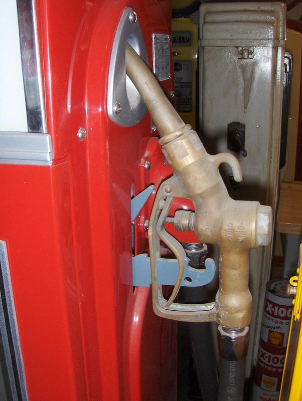

Here is how a nozzle fits on your style nozzle rest. You will need one with the slot in the front.

Guts are still in tact. I have not removed anything out. Took panels off so to display. I plan on taking folder of pics of pump with me. There is a porcelain electrical base on top - and inside the top. I assume the original but appears to be cracked. For light bulb and globe I assume. Thanks for pic of the handle - I know what to look for. Thanks all for the help!

The above visi is for a G&B not a National. The National visi is octagon not round. I believe there was two or three variations of their octagon visi, not not sure witch one is correct for the National 90.

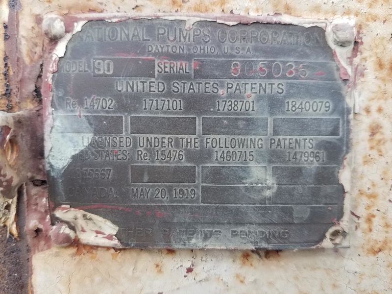

The pump also has Bowser hands on it. National made a number of changes on the 90 over the years. Pumps with serial numbers from 901-905791 had different a different reset; faces; bezels and top casting to name a few. The reset went to the side (not through the glass) on the later ones.
