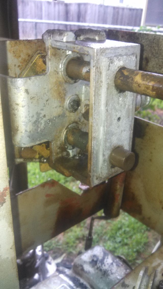

Photos of a thingy on pump frame I can't figure out. When computer mounts the part opposite from reset handle engages into it. This thing also has linkage that goes down to switch on motor but why does the computer engage it?

Are you planning on the computer cranking to reset or are you just going to set it at zero and disconnect it? If you are doing the later, you need not dis-assemble it. Simple rotate the numbers until you get the correct ones you want facing front. If you want the first option? Most of us use either Joe Yokum or Tom Buckles, both are on here, for computer rebuilds. Both are very qualified and your computer will be perfect upon the return. Paul www.severngaspumps.com

I want to make it reset and work when powered by electric motor. Would either of these two sell parts. I want to fix it myself. If I had a rebuilt computer I still need to know why both sides of the computer is connected to the pump.

You need to speak to them. I am only offering a solution. Paul www.severngaspumps.com
