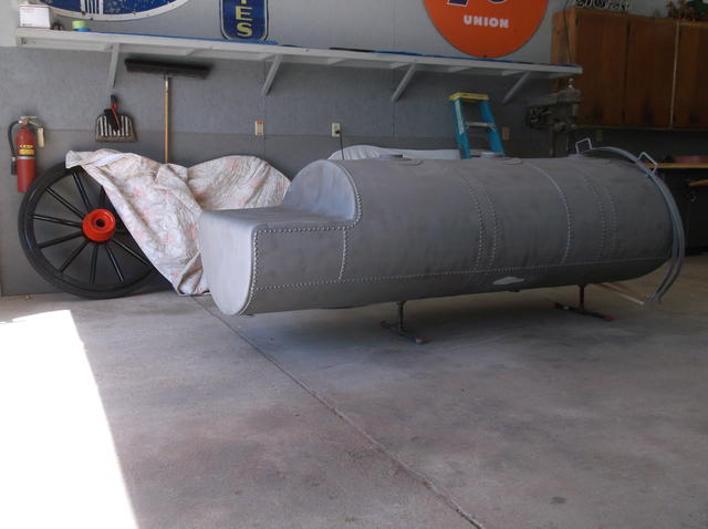

Thank you, all, for the positive comments. To answer some questions. As much as this needs horses, we are not going to go that route. Expense, time and care involved. This will be set up so that it can be pulled by horses, but for now it will be pulled by a mule (Kawasaki). We have decided against branding, so it will be generic. Colors will be Phillips orange and black. With gold lettering for the signage. My wife picked the colors off a Phillips shield in the shop. The wheels are in So. Dak. @ Hansen wheel and wagon. We are having the hub bands tightened and rubber tires installed instead of the steel. Quieter, softer ride on pavement, and the wheels should stay tight longer. The oak bows for the top are steam bent and purchased from the Amish.

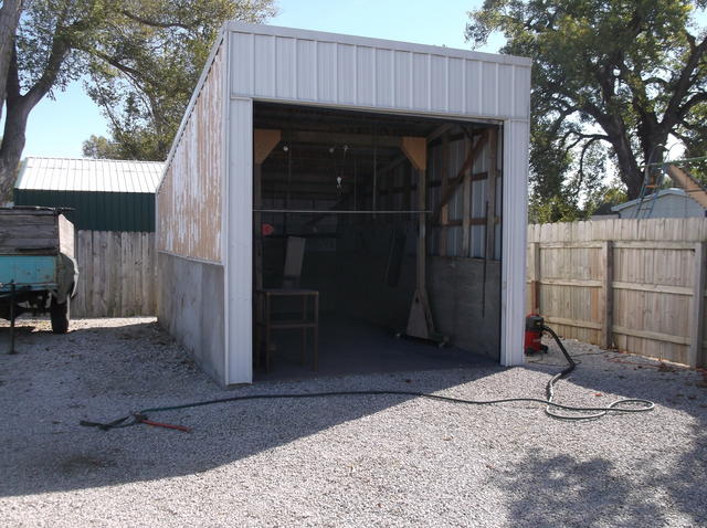

I took some days off starting around Labor day and took this all apart and sanded the wood and blasted the metal. We had a great autumn for painting. It took about 6 weeks to paint. I used a building that I previously used for road salt storage for my paint booth. A picture of modifying a pole (tongue) blank to fit the wagon. The booth. Blasting the front axle.

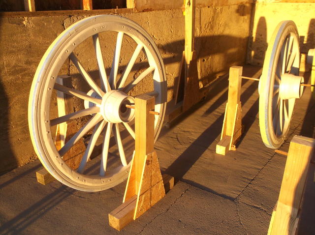

Some of the progress. There were 7 sets of painting, each had primer, first and second coat. The wheels had 5 coats. The wheel stands took 2 hours to make, but were well worth it. Just spin the wheel to paint where it was comfortable.
