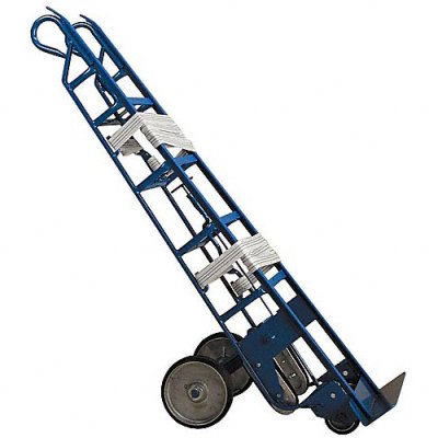

Dave, some furniture/appliance dolly hand trucks have a support swing out arm with wheels that lay the load back at an angle, are you talking about those?
Posts: 1,661
Posts: 1,661
Here's another version
All these are available at handtrucksrus.com
This last one is rated at 1600 lbs, enough to handle all but the largest items.

I think Tom Buckles used something like the yellow or blue one to move pumps at Columbia.
