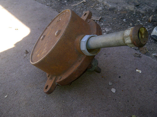

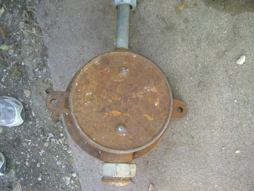

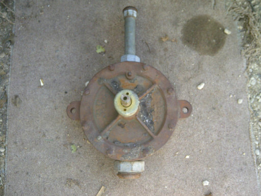

I picked up this external pump today hoping it would fit my pump,i did not have a tape to measure from ear to ear,but it seemed close enough,well im 1/2 " off aggggggggggggggggggggggggghhhhhhhhhhhhhhhhhh! i though i had my pump, if i pull this away from my pump and line the ears up and pull back 1/2 it lines right up,was there some type of bushing that went between pump & brackets ?
patent date 1924
stamped AA

DIESEL #237975 Thu Mar 03 2011 03:32 PM
Joined: Nov 2009
Posts: 2,336
DIESEL Offline OP
Joined: Nov 2009
Posts: 2,336
PIC,I CAN GET BETTER PICS TONIGHT ,I WAS RUSHING ,BUT THIS IS REALLY CLOSE,CAN ANYONE TELL ME IF THERE WAS ANYTHING IN BETWEEN,LIKE A BUSHING ,OR SPACER ,BETWEEN BRACKETS & PUMP? AGAIN I WILL POST BETTER PICS TOMORROW SO IT MAKES MORE SINCE! OR IF ANYONE CAN ID THIS PUMP?

Rush Manufactured, Pat date 1924.

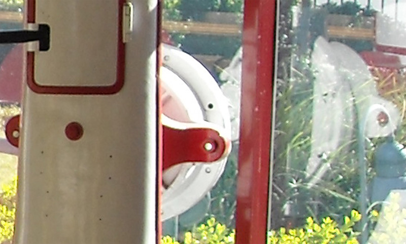

I have found these mounted in base of Mae West 17's & 117's. All I have seen mounted on outside had mounting lugs on back casting, unlike what you just got w/ lugs on front casting.
Even through my 17 has a different outside bracket, you can see in refection that lugs are on back.
You might get lucky by wobbling out the holes for mounting.
im sure gonna try,untill the correct pump comes along,hopefully one will pop up at peotone?

Congratulations on finding any type of pump that close! I would shurely try to adapt it. Machining each of the holes on
the mount and on the pump 1/8 would even out the alignment.

That pump mech. should fit in base of Mae West & Rush "H" Stove Pipe, maybe the "K" also.
